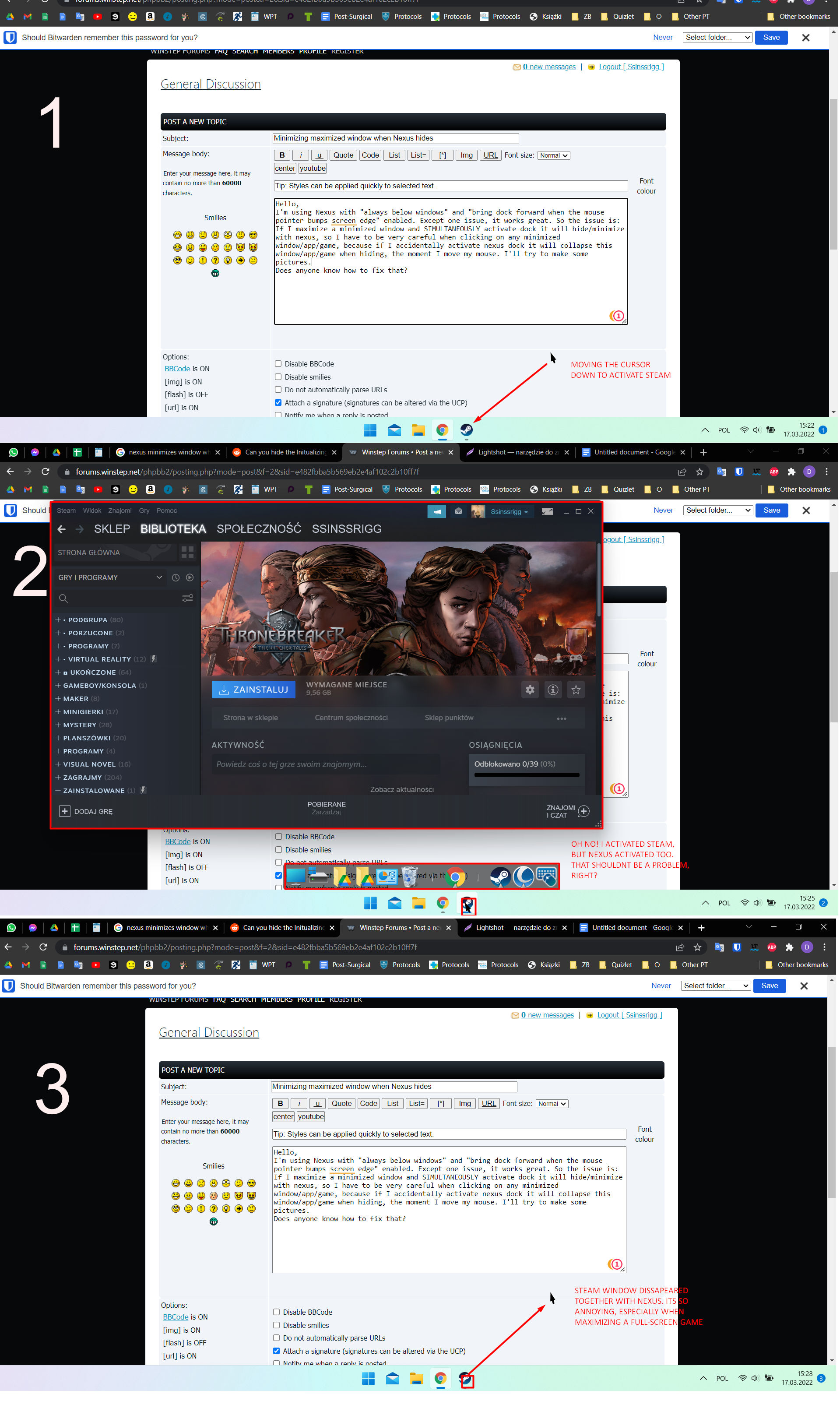

Hello,
I'm using Nexus with "always below windows" and "bring dock forward when the mouse pointer bumps screen edge" enabled. Except one issue, it works great. So the issue is:
If I maximize a minimized window and SIMULTANEOUSLY activate dock it will hide/minimize with nexus, so I have to be very careful when clicking on any minimized window/app/game, because if I accidentally activate nexus dock it will collapse this window/app/game when hiding, the moment I move my mouse. I'll try to make some pictures.
Does anyone know how to fix that?

Ehhh...
I'm not quite sure if you guys understood what I'm asking about.
My problem is NOT that Nexus is accidentally activated when I try to maximize something. I'm fully aware of how I set up the program and how to change it. That would be a really stupid question if it would be just blaming software that I'm accidentally activating a dock.
My problem is that it's MINIMIZING OTHER APPLICATION WHEN HIDING. My question is not "how can I avoid accidental activation of the dock" but "can I prevent the dock from minimizing other window when hiding". I like Nexus the most, but other docks doesn't have that issue as far as I remember. Hopefully it's clear enough now, sorry if it wasn't before.

OK, to begin with, it might help if a) you could state what version of Windows you're using, and what version of Nexus Free or Ultimate, and b), if you could make a step-by-step list of what you are doing and trying to achieve.
Also, you are using incorrect terminology - e.g., it is plain to see that the 'Steam' window was not 'maximised' but rather, 'restored'. The maximised window is beneath it, i.e., your browser. And 'Full Screen' is decidedly not the same as 'maximised'.
I completely fail to understand just why you would want to un-hide your dock *and simultaneously* launch/restore/maximise an app/window. It really doesn't make any sense, nor can it even be achieved - it only can be achieved sequentially, in my experience.
As for the 'Steam' window being minimised when the dock hides, that is not a behaviour I've personally seen. It seems to me that there's something very screwy going on.

Sorry for a bad terminology. I'm using Windows 11 Home; so far free version of Nexus. I'm just having difficulties with being more clear, I provided photos with description on them (written in red; have you noticed these?) that should explain step-by-step what I'm doing. Ehhh... I don't want to un-hide the dock and restore a window. I'm un-hiding it by accident, but that is not an issue. Accidental activating a dock wouldn't bother me if dock wouldn't minimize any window I restore while dock is un-hided. As I mentioned before, it minimizes any restored window, even it's a video game that goes to full screen. As a result, that game goes full-screen for a second and the exact moment when dock is hiding it minimizes it.
Please don't feel like I'm upset or something; I appreciate any help.

Yes, 'maximised' and 'full screen' are very different beasts indeed! However, if you look at the image, the app in question, i.e. Steam, is *not* actually being maximised but just restored to a normal window. :)

Hey guys, I solved it.
So, dock was auto hiding and minimizing any restored window when activated, but 'auto-hide' option was actually off. Enabling auto-hide fixed this issue.
Problem solved, thread can be closed :D
PS @WINSTEP — it was happening with any restored window, 'regular size', maximized or full screen.
