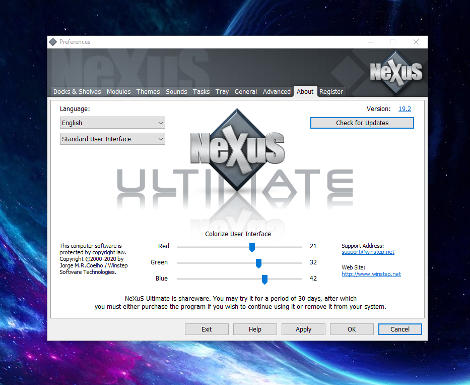

Also, can you post a screenshot of the About tab in Preferences, please?

I'm still using the 19.2 Ultimate installer that I got last year when I ordered.
File comment: About Tab

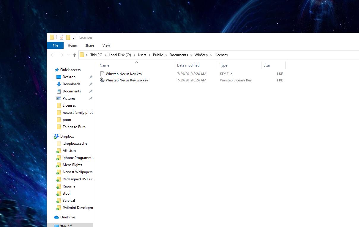

File comment: Key pic

Ah-ah! I knew it - someone has a hard time reading the manual before engaging in action, and then the table gets mounted upside down lol
Since when is the key file named Winstep Nexus Key.key ? The ACTUAL and ORIGINAL filename is Nexus.key - no wonder the software didn't see it. :)
So, rename the file Winstep Nexus Key.key to Nexus.key (and make sure Windows is not hiding file extensions so it doesn't become Nexus.key.key instead), open Preferences, go to the Register tab and click the 'Register' button.
Also, please delete the Winstep Nexus Key.wsxkey file.
