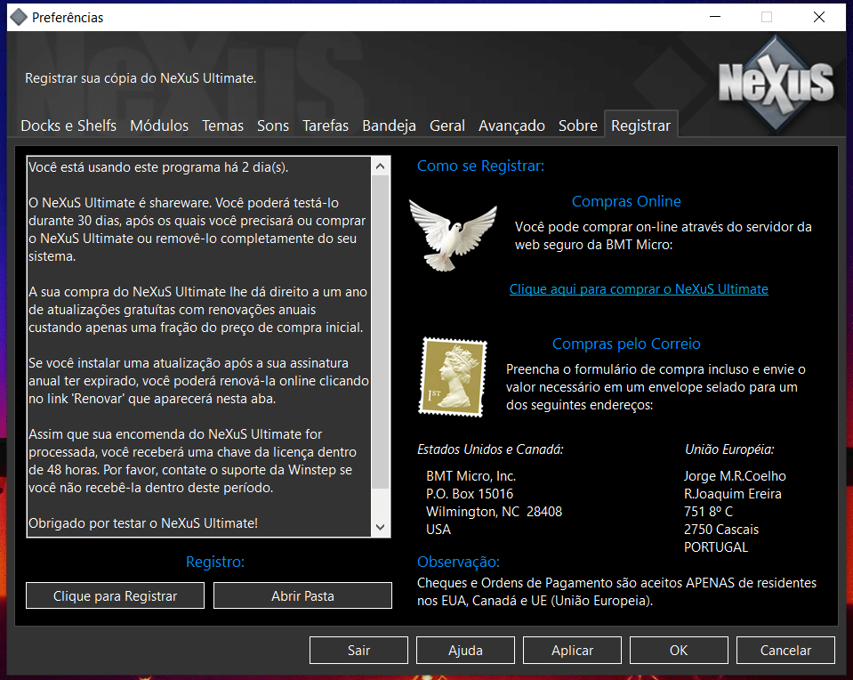

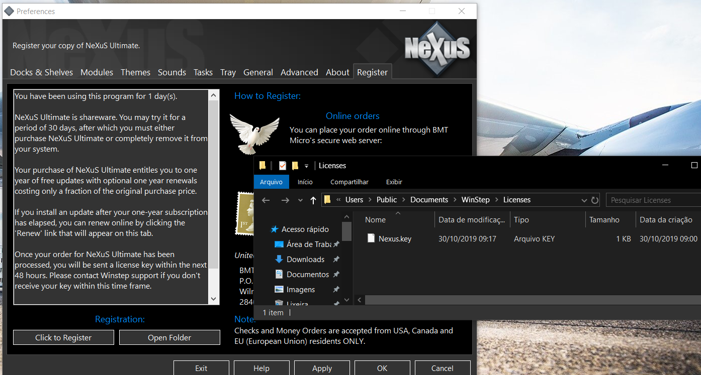

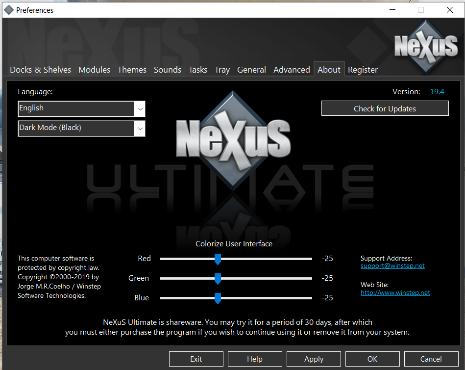

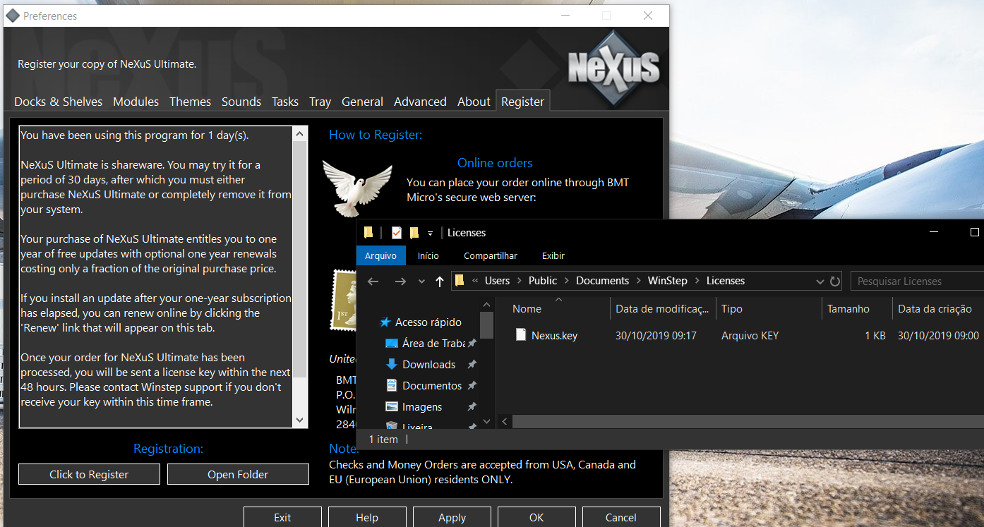

Man, nothing done. I have made your suggestions without success. there is a "click to register" button. There are two fields that must be completed: "Licensed to:" & "License serial number:". I think it would be faster and less painful for me to email me this data, or I will necessarily have to start a ground zero installation as a last try. Can we end this nightmare, Jorge?

I sincerely don't know what might be going on in there at this point. :shock:

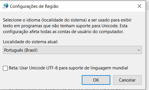

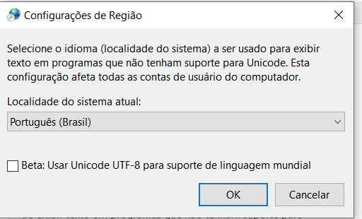

One last thing to try: your Windows version seems to be in Brazilian Portuguese, right? If you go to the Windows Control Panel, Region applet, Administrative tab, what is the current language for non-Unicode programs set to?
Click the 'Change System Locale' button, change the Language to 'Portuguese (Brazil)', make sure that 'Beta: Use Unicode UTF-8...' is NOT set and reboot your system.

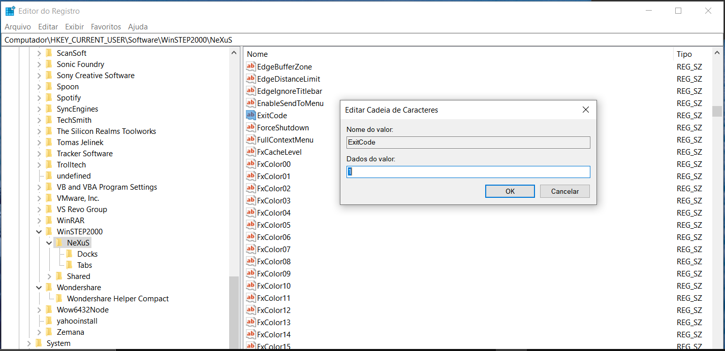

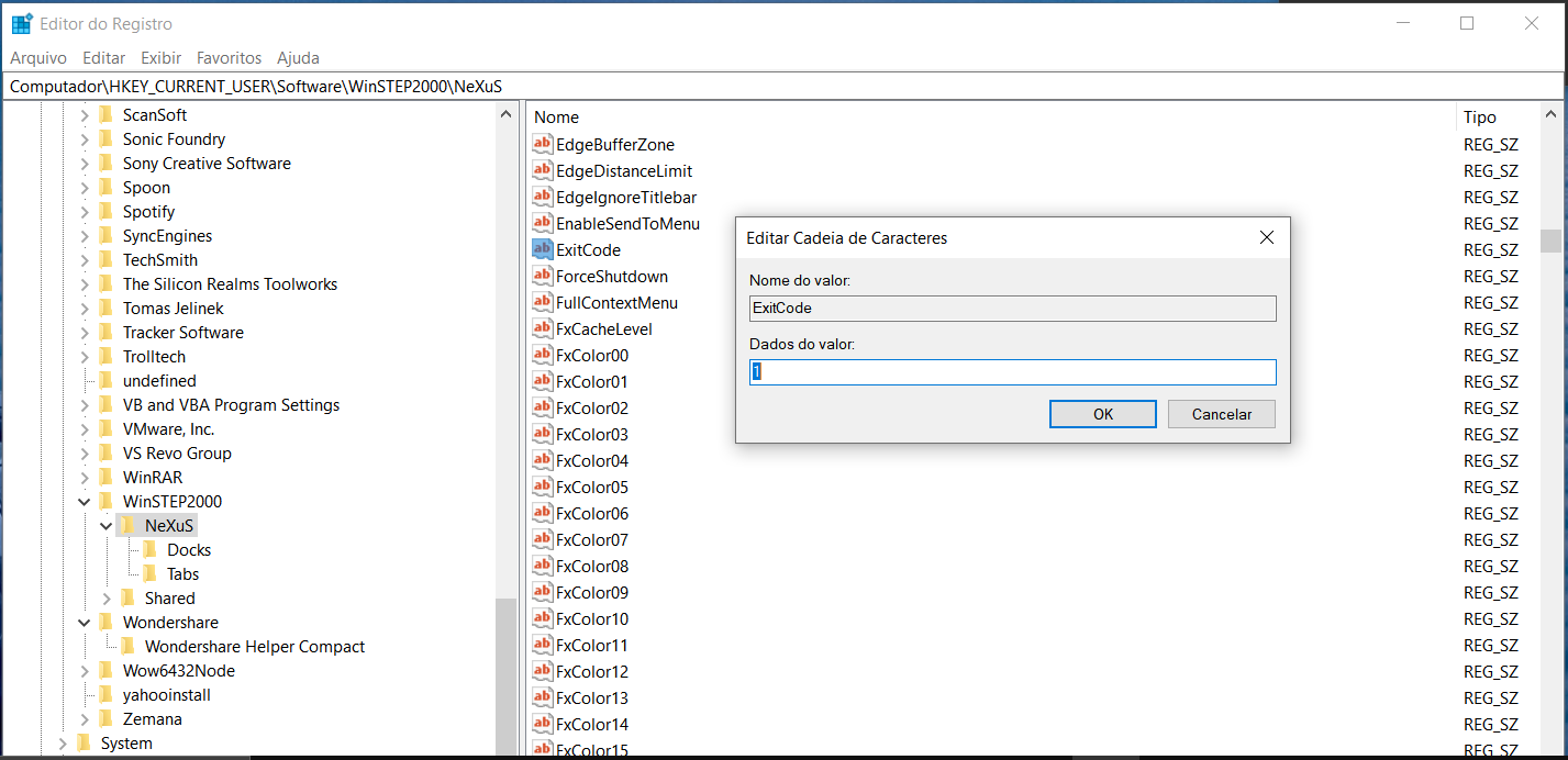

ALSO: open the Windows Registry, go to
and look for an ExitCode entry. Paste the value it holds here, please.

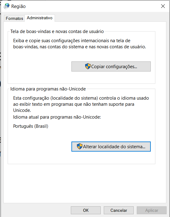

that´s it:

PIC 1) "what is the current language for non-Unicode programs set to?" PORTUGUESE-BRAZIL.

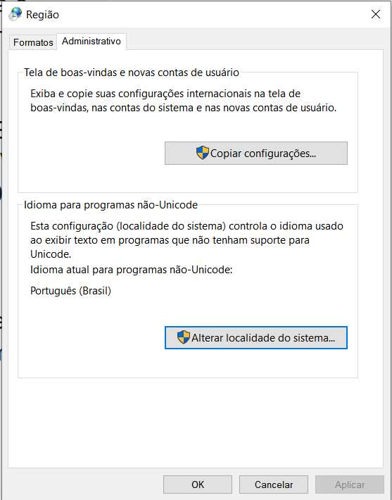

PIC 2) "make sure that 'Beta: Use Unicode UTF-8...' is NOT set and reboot your system."
NO, IT ISN'T.
PIC 3) "ALSO: open the Windows Registry, go to
and look for an ExitCode entry. Paste the value it holds here, please." OK, I DID. THIS IS THE SCREENSHOT.
NOTE: I'm not a T.I. Professional. I think just answered your questions. Can you REALLY tell me whats happening with the register, please? i'm the client, right?

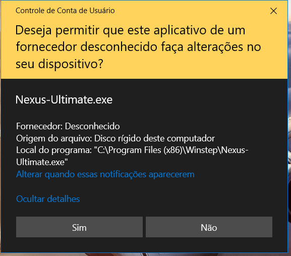

Maybe it has something to do with the Windows VirtualStore (part of the virtualization technology that was introduced in Windows Vista). For a program to be eligible for virtualization, it must be 32bit, not running with administrator rights and must not have been compiled with a manifest file indicating it is for Vista or later.
When a virtualized program attempts to write to a protected location such as Program Files, Windows will intercept the access denied response and redirect the write to C:\Users\<name>\AppData\Local\VirtualStore, which is a hidden folder.
When a virtualized program attempts to read from a protected location, Windows will first check for a copy of the file in VirtualStore. If it finds it, it will use that copy. Otherwise it will attempt to read from the original file.
So, perhaps you are storing the key file in the correct folder but the Winstep application is trying to read from the (empty) virtualized Licenses folder in the VirtualStore.

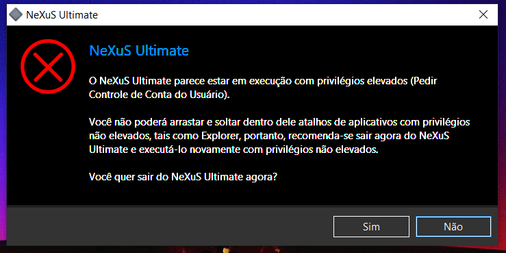

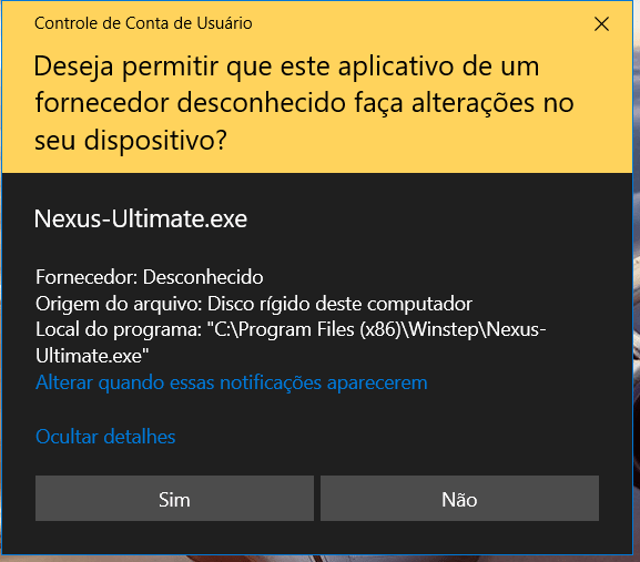

So let's give this a try: exit Nexus Ultimate then right click on the Nexus Ultimate icon and select 'Run As Administrator'. You will get a UAC prompt and then a warning from the Winstep application after this, but if my theory is correct you will also see that the application is now registered.
Once you have determined this please immediately exit Nexus Ultimate, a program launcher should NEVER run elevated (as any applications it launches will then run elevated as well, a good way to get your system p0wned in a short amount of time).
Let me know either way, please.

the annual subscription will expire and we will be posting screens here ... as expected, nothing has changed...
.........so?

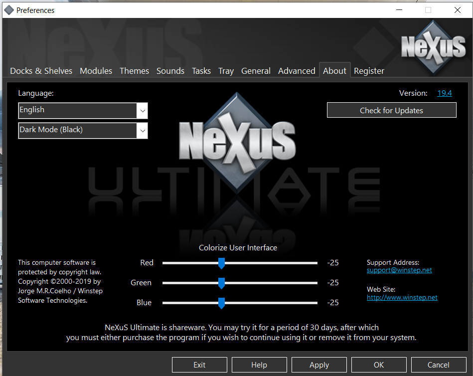

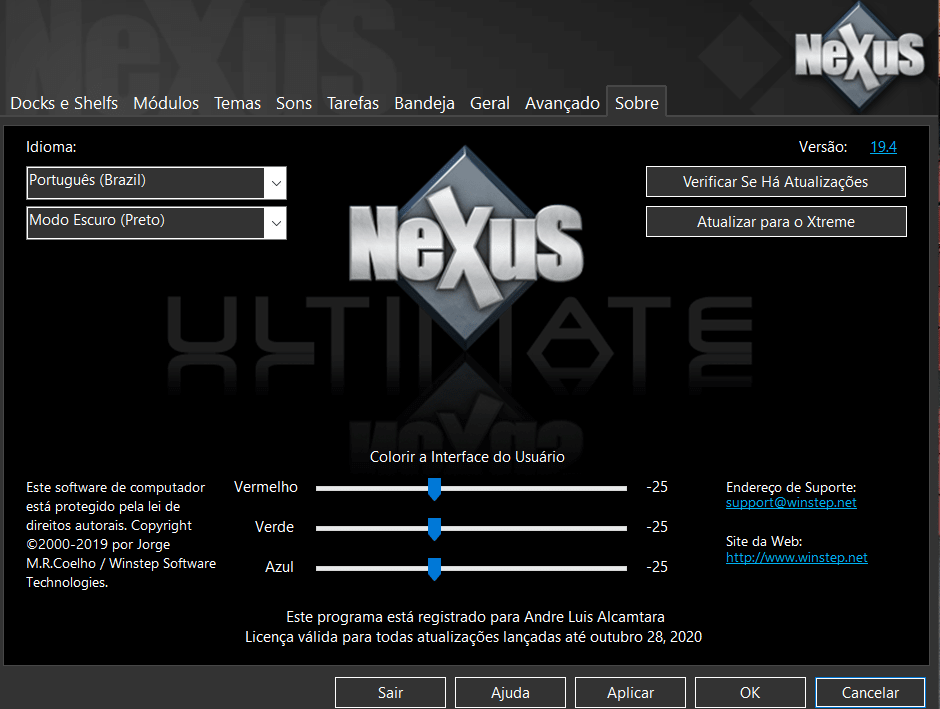

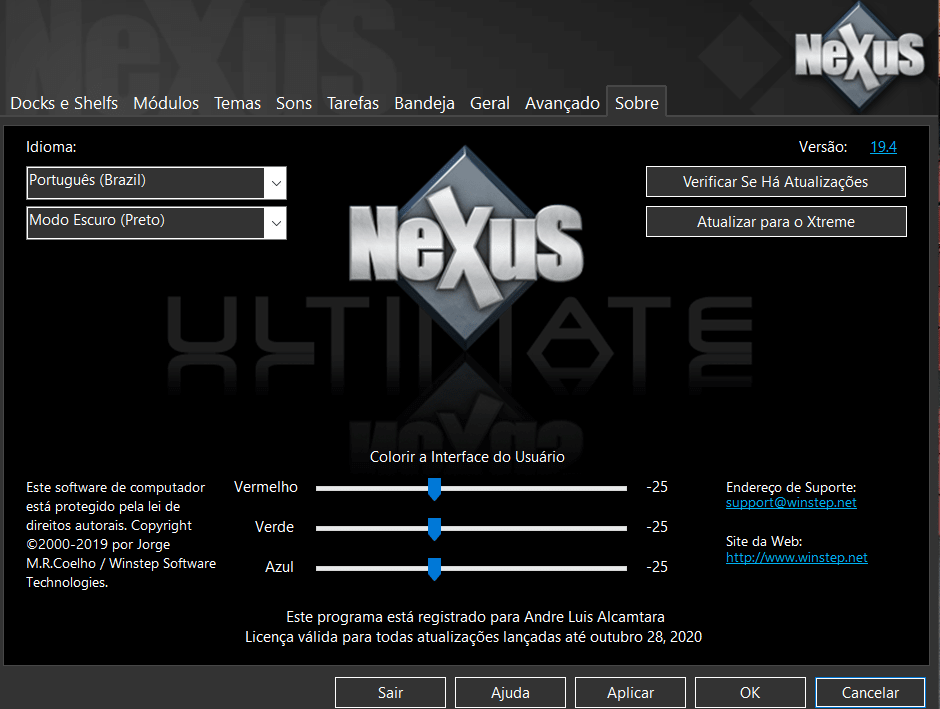

Well, well, well ... I bought a perpetual windows 10 PRO subscription, installed it from ground zero and voila! Product registered!
My Old Windows 10 was home edition OEM.
By the way, my name is Alcântara with "N".
Thankful.
Best Regards.

So, application is the same, license key is the same, the only thing that changed was the OS - that should tell us something lol
Still no idea what could have caused the license key file not be read properly, but ah well... it's working now.
