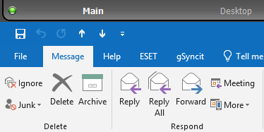

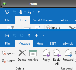

I have a horizontal workshelf that autohides across the top of my main monitor. it has worked flawlessly for years (and still does). But I've noticed since the most recent update to Xtreme that it does not play well with MS Outlook (or Outlook does not play well with Xtreme anymore :roll: ).
When the workshelf is running, I open Outlook and it goes fullscreen as usual and without any issues. I can then double-click on a message to view it - the message also goes fullscreen without any issues. I then close the message.
When I open either the same message or another one in the message list, the message does not appear in the same place as the previous one. It is almost as if some sort of "margin" is being reserved by the Xtreme Workshelf - the result is that the new message is shifted down the screen, roughly by the height of a window titlebar.
Repeating this process results in each newly opened message shifting further and further down the screen. If I try and drag the message window back to the correct place just below the workshelf, the message window is no longer maximised and it jumps down to where it was previously, with a large "margin" above it.
However, if I close the workshelf, then MS Outlook works flawlessly again, displaying opened messages as expected. If I then start the workshelf, Outlook message windows are displaced down the screen again.
Outlook is the only application that I have noticed exhibiting this issue. Unfortunately, it means I have to keep my workshelf closed.
I've included some screengrabs to show the vertical shifting. I hope this all makes sense :)
Any suggestions / ideas please?
Thanks,
Mike
P.S. I'm running Windows 10 Pro 64-bit v.10.0.17134 build 17134, dual monitors with Xtreme versions: Workshelf.exe v18.05.1320, Winstep.exe v18.03.0116

One question though, to determine whose fault it really is: when a message has already been displaced down the screen, what happens if you maximize *some other* application?

All other applications I've tried work fine - hence my tongue-in-cheek when I said the issue lies with the workshelf :shock: I'm sure it is Outlook as it is the only application that behaves this way.
Then again, Outlook is the only application I have that opens multiple windows in the way it does. Tabbed windows work fine in maximised applications (Google Chrome, MS Edge, JetBrains PhpStorm, etc...) and other applications are fine when maximised, just Outlook exhibits this issue.
I suppose the idea might be to see if anyone else has experienced this issue - at least it would highlight a common conflict or narrow it down to my configuration.
I'm not suggesting that you consider working out a hack for Outlook, but rather be aware of the issue. I can't sensibly think why this would happen other than Mickeysoft employing hacks within Outlook (I can't imagine that *ever* happens).
By the way, I've tried limiting the programs that run at system startup, closing running programs in the system tray area, running some but not others, etc... and Outlook behaves the same in all situations.
Thanks again :) Great product(s) by the way!

Seems to me MS Outlook 2016 programmers failed to take into consideration the possibility of someone having an appbar reserving screen space at the top of the screen, which is a totally rookie mistake.
Something else for your to try (and then let me know, please): temporarily undock the Shelf then drag your Windows taskbar from the bottom to the top of the screen (make sure it is NOT set to auto-hide). The Windows taskbar at the top of the screen will do the same the Shelf does (i.e.; reserve screen space for itself), so lets see how Outlook reacts in that case.
 Post subject: Re: Workshelf seems to conflict with Microsoft Outlook 2016
PostPosted: Fri Jul 06, 2018 3:02 pm
Joined: Fri Jul 06, 2018 10:55 am
It's surprising over the years how many applications were badly written in so far as their playing nice with appbars.
I tried what you suggested - I undocked the dock and shelf + removed auto-hide, moved them around the screen, moved the Windows taskbar to the top - and guess what? Exactly the same thing happened, as you anticipated.
Then I moved the taskbar back to the bottom edge of the screen whilst leaving the dock and shelf floating, and Outlook behaves itself.
So it looks like it is poor coding within Outlook :lol:
My workaround seems to be a dock fixed to the top edge of the screen, set to auto-hide and stop using a shelf on monitor 1 (I've moved it to monitor 2). The shelf is reserving the screen real-estate anyway, so I can live with this for now.
I'm not going to hold my breath for a Mickeysoft fix though :roll:
Thanks for all your input! :)
