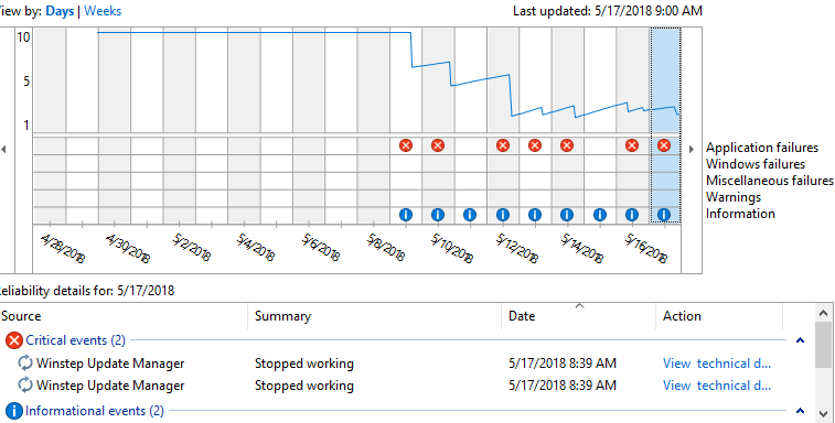

Hello, a pleased new user here and this issue doesn't seem to be major. Below is a snip of Reliability Monitor and almost every day, wsupdate.exe/Winstep Update Manager "stop working." Every red mark under Applications is from Winstep. Only using the dock at the moment and it loads just fine despite the delay. Fast startup is disabled. Windows 10 v.1803 fully updated. No malware.
Manual check for updates says all Winstep apps in my comp. are currently up-to-date. WSUpdate.exe version 18.02.0188/Winstep.exe 18.03.0116. Product version:18.03.1091.
The errors don't seem to affect any functionality. I won't enable Fast Startup for this machine but I do see it is recommended by Winstep to enable it. Thanks for any info.

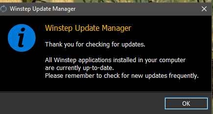

OK, just to show the result when you right-click the dock and then select Nexus/Info/Check for updates:
I was just going by manual checks and the resultant messages like above. I downloaded from your link and extracted the updated .exe into the existing Winstep folder so that the WSUpdate.exe version is now 18.05.0189. Also, the product I have is paid for and registered appropriately. I will evaluate and post back in a few days as requested.

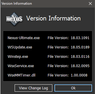

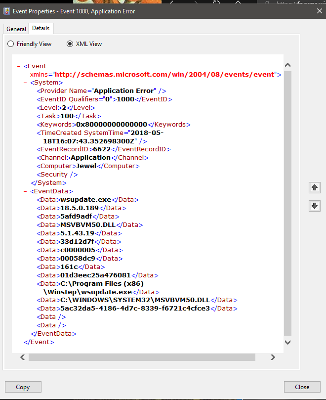

Unfortunately, the "crash" recurred today despite introducing the updated .exe. Winstep has never notified of the failure, though Windows always does. Also, doing a manual check for updates now doesn't show any message at all. Below are snips of the Event Viewer error and a snip showing the updated .exe from the above download. It doesn't seem serious but I, like many probably, don't like to see errors with frequency.
Anything else I can do? To add as an edit: for Automatic Updates in Advanced tab: Notify me when new updates are available and notify me of language updates are activated. Insofar as running the command prompt, if this is still necessary, more specific instructions are asked for. Thanks.

Yes, you were right, I could reproduce the issue here on a Windows 10 VM and this time it seems like I really fixed it.
Please download again from the link above. New file version is 18.5.190
