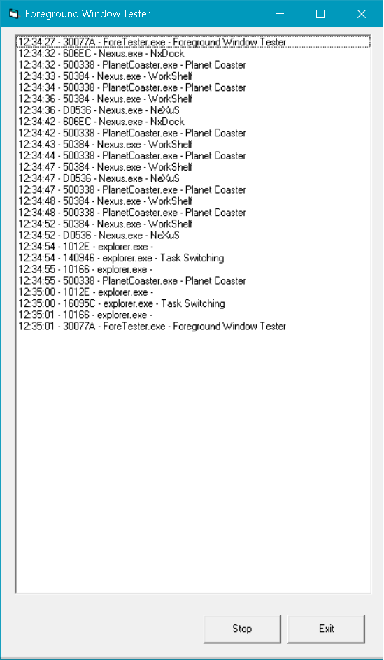

I have also download the foretester.exe file and ran that while checking what was happening. And indeed it does seem to be stealing focus from the game unless I use the ALT-TAB method.

File comment: ForeTester.exe results

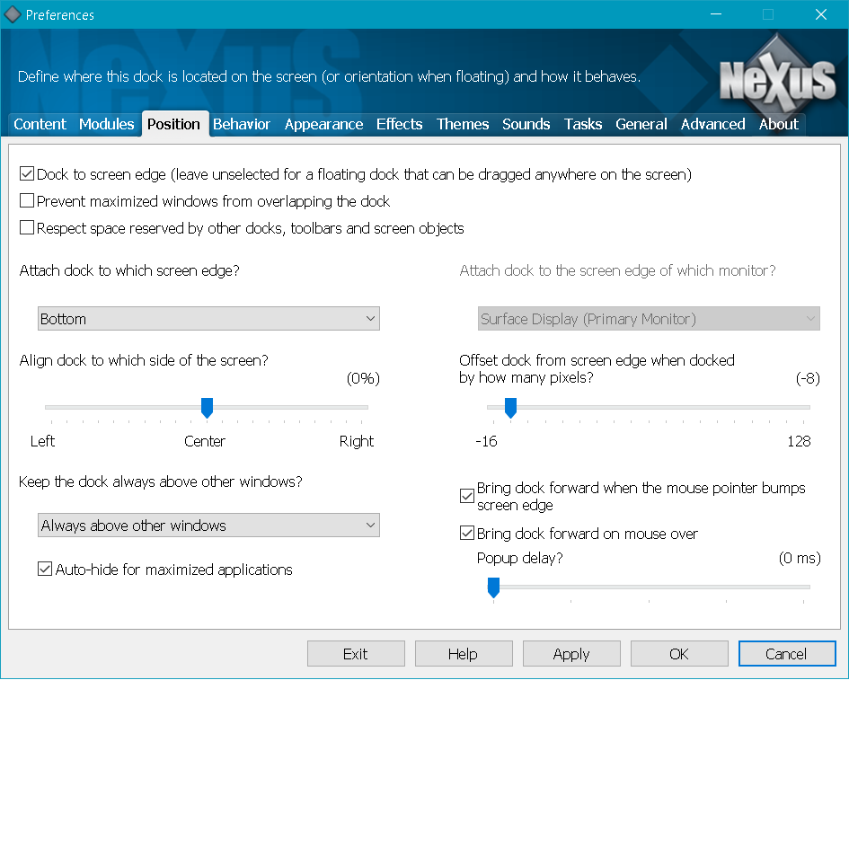

@WINSTEP Thanks for the promptly reply.
One question: in the Position tab, are any of the 'Prevent maximized windows...' and 'Respect space reserved...' settings enabled? If so, try disabling them and let me know what happens, please.
Both of those options are disabled. The only options I have regarding position enabled are "Autohide for Maximized Applications", "Dock to screen edge" and both "Bring dock forward" options. Please see screenshot for details.
