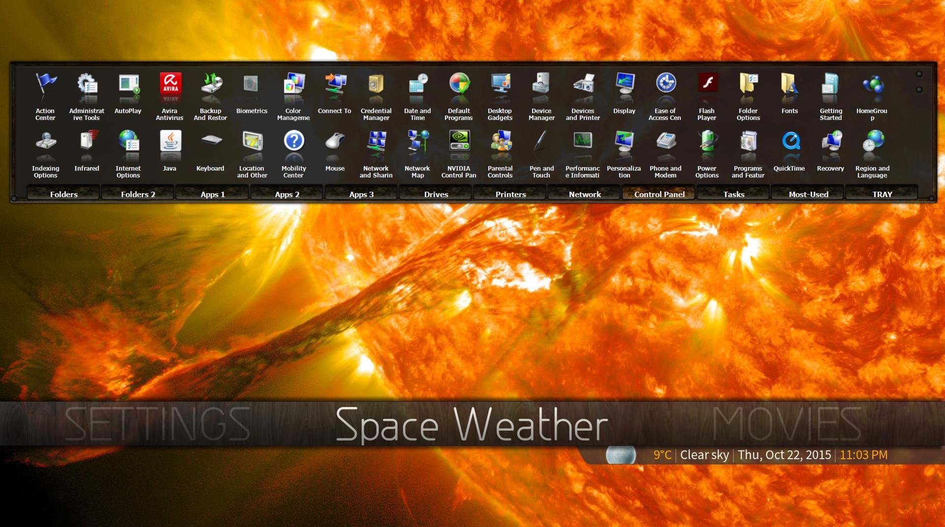

I have Extreme installed on my laptop. When Home, I have it connected to a second larger monitor situated above my open laptop screen and use both monitors. In this mode I have the shelf docked to the top of the upper/second monitor. When I then double click on a shelf tab, instead of expanding, the whole shelf shifts down lower on the screen about an inch or so away from the top of the screen. Bumping the top edge now brings up the dock in this new lower position. If I double click a tab again, it shifts even lower. The only way I can get it docked back to the top of the screen is to restart Workshelf.
Can you please post a screenshot of this issue? It would help me visualize better what is happening (as well as see how the Shelf is setup at the top of the screen, i.e.; if the tabs are inverted or not).
The image is of my upper, external monitor showing where the shelf ended up right after i double clicked on the Control Panel tab. If I double click on it again, it will move even lower by the same amount.
I have always used the shelf on the top of the screen. I have a dock on the bottom of the laptop display and another smaller dock on the left side of the laptop display, and the shelf is either at the top of my laptop display or, if connected to an external monitor, at the top of the second monitor, with the tabs along the bottom.
And the Shelf is set to reserve screen space, I bet... if you disable that option for that Shelf, this doesn't happen?

Are you referring to under the Properties for the shelf, Position tab, "Reserve Edge pf Screen" at the bottom, Yes, both options "Prevent Maximized Windows..." and "Respect Space Reserved by..." are checked. de-selecting them both in various combinations changes nothing, same issue occurs.
Doh. Are you sure? The only time I have seen this happening was because either 'Prevent maximized windows...' or 'respect space reserved...' were turned on.
So, to recap, this only happens when the secondary monitor is attached to the laptop, right? One more question: when you double click the tab for the first time, besides moving down, does the Shelf *also* expand as it should? i.e.; it expands *and* moves down?
Yup, I'm sure, checking all four combinations of those two settings yields the exactly the same results in this matter.
Yes, correct. With the laptop running on it's own and the shelf docked to the top of it's screen, double clicking on a shelf tab correctly expands the shelf.
No, in dual monitor mode, double clicking on a tab only causes the whole shelf to move down, it does not expand.
