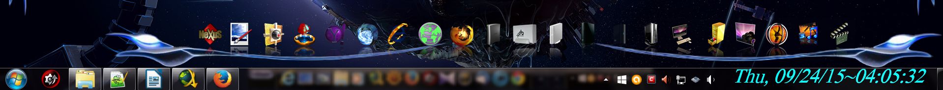

As you can see, the Winstep taskbar is underneath the Windows one.
Are you able to reproduce the issue if you enable the settings and procedures I used?
Where is 'Prevent maximized windows from overlapping the taskbar' located? I can't find it. I've been enabling all of the settings via NextStart > Taskbar tab. I also checked the settings via WorkShelf and the Control icon on the dock.
As far as removing the system tray icons from the desktop, I found the solution. 'Detach the system tray from the NextStart taskbar' was ticked. I unticked it and the icons no longer show.

You can't keep the NextSTART taskbar always on top of the Windows taskbar, because both will be fighting for 'always on top' status - and only one can have it.
If you dock the taskbar, it will reserve screen space for itself and it will respect the space reserved by the Windows taskbar, i.e.; it will appear right above it.
TL;DR, Two bodies cannot occupy the same space. ;)
