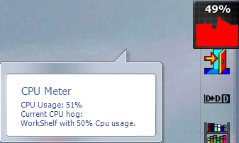

[2015-01-04] at this start WorkSelf occupied the cpu for about 5 minutes, before I decided to put the system into sleep (for about 2h). After that it behaved normally, that is, used only 1 - 4%:
What is WorkShelf doing in this time?

Good question, and, as you stated, it was apparently related to your connection being down. Does it happen again if you turn off your Internet access manually?

It could be a 'false' case of CPU usage (i.e.; WorkShelf is actively relinquishing processing slices to the OS while it waits for an operation to complete, which make it seem like it is using a lot of CPU when it really is not). To test for this, run another CPU intensive app at the same time to max out the other CPU core and bring CPU usage up to 100%: does the computer feel 'sluggish'?
