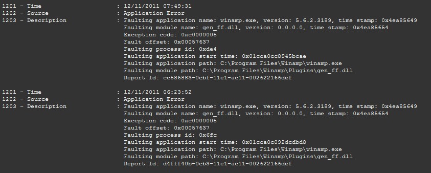

There is nothing wrong with it at first sight.
Hmmm... On a hunch, judging by the size of the letters in that screenshot, you seem to be running with large fonts (high DPI) enabled. Could you try setting the screen DPI to normal (100%) and see if that fixes the problem? You can do that from the Display applet in the Control Panel.
I know at first sight this should have nothing to do with it, but bear with me please. If it works I'll tell you that joke about the broken car, the mechanic, the electrical engineer, and the IT guy. :D

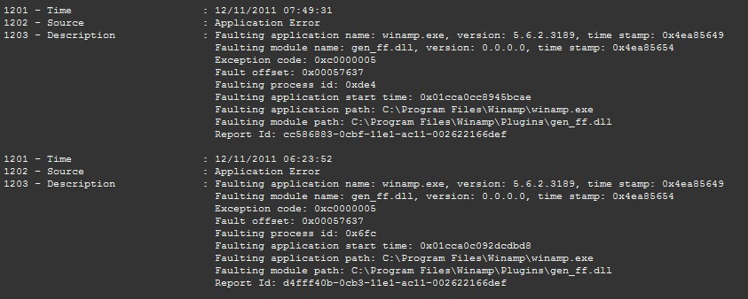

Does this help?

Have you seen the pic I added afterwordsin my previous post ?
 Post subject: Re: Cannot launch winamp from Nexus
PostPosted: Sat Nov 12, 2011 12:16 am
Posts: 13140
Try Googling for 'gen_ff.dll error', I get quite a lot of entries for that.
