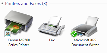

Another thing is that the printer and fax shortcuts work with no problem in Xtreme, but I notice that they are in a different area than the scanner launch point. I have to click on the printer icon to get to where the scanner properties and launch point is.

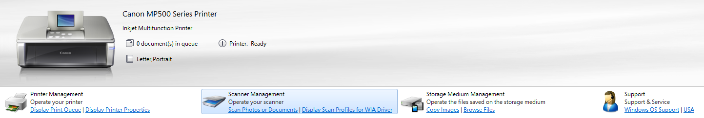

This is after clicking on the printer. Then I have to click on Operate your scanner to get to the scanner area.

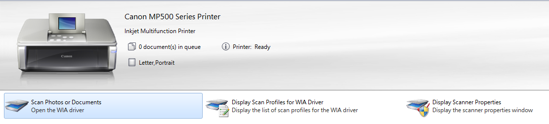

Then I have to click on Scan Photo or Documents to open the dialog box to scan. This is also where I send the shortcut to the Desktop from.
