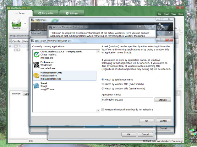

Add it to the Thumbnail exclusion list (WorkShelf Preferences -> Tasks -> Advanced -> Thumbnail Exclusion List button).
If this solves the problem, please let me know the name of MailWasher's executable so I can add it to the default exclusion list.

Thanks Jorge for the suggestion, but sadly it didn't fix the problem. I added the program .exe file to the exceptions list as you suggested, but still had the same issue.

I forgot to mention that I set the thumbnail exclusion to match by application name, which was the same for other programs in the list. I hope that's correct?
I also tried enabling as well as disabling the 'retrieve thumbnail but do not refresh it' option, but the same problem occurred both ways.
